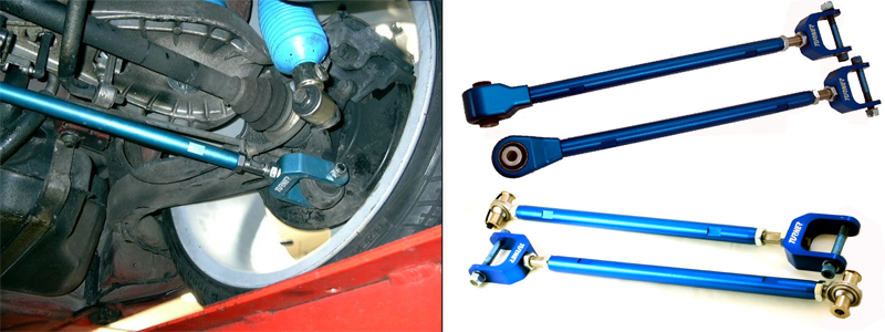

CSDD TA laiž cauri aftermarket camber arms?
